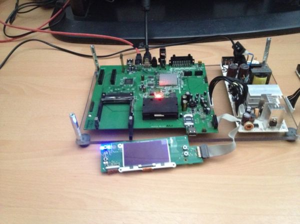

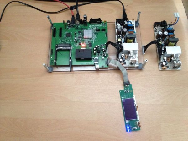

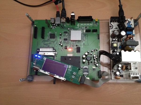

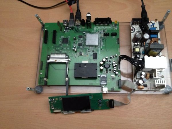

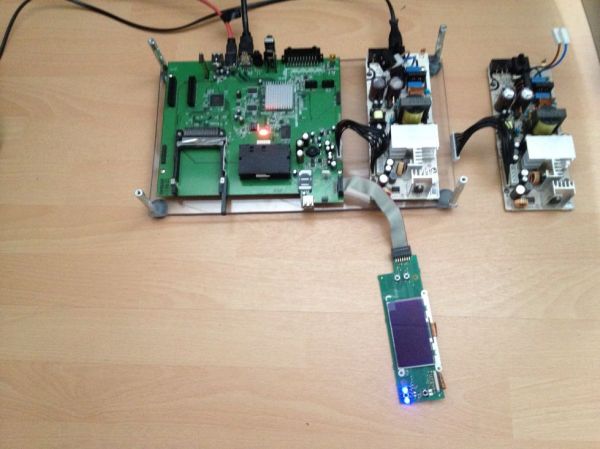

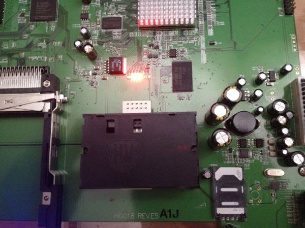

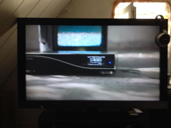

Lorelito vorebbe qualche infos e aiuto / Lerelito would need some help and infos about his DM7020HD that doesn't boot, he can upload the image/firmware but then the box doesn't boot and the front screen panel (OLED) stays black.
Thank you !
Photos :

A better, bigger, sharper picture of the last picture, especially from the dc/dc voltage regulators area could help.
