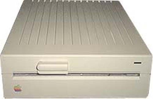

Apple FDHD External (G7287)
The FDHD External uses a similar case to the 3.5" External but the 800K mechanism has been upgraded to a 1.4M mechanism. With appropriate software, it is capable of reading PC format disks in both the Mac and Apple IIgs.
It was designed for use with Macs with an FDHD disk controller (eg SE FDHD, SE/30, IIx, IIci). If used with a Mac that doesn't have an FDHD controller, it will operate as an 800K drive. It should not be used with the Mac 128K or 512K.
The FDHD can also be used with Apple IIs fitted with a "SuperDrive controller" or a suitable third party disk controller. If used with a IIgs that doesn't have a "SuperDrive controller", it will operate as an 800K drive.

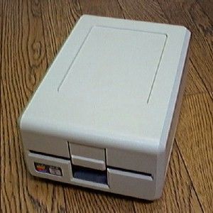

Disk II
The Disk II was Apple's first drive for use with the Apple II. It is attached to the disk controller by a ribbon cable; this can be changed for a 19 pin D connector so that the drive can be used with later Apple II models or the 5.25" drive controller card.
The Apple III and III+ can use a Disk II with a modified analog card; I have not found details of these modifications on the web.

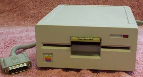

Unidisk 5.25" Drive (A9M0104)
The Unidisk 5.25" was Apple's replacement for the Disk II. It is a half height drive in a beige case and uses the 19 pin D connector. It was the first 5.25" drive to feature a pass though port.
(Photo courtesy of Bryan Villados.)

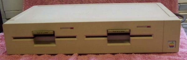

Duodisk 5.25" Drive (A9M0108)
The DuoDisk is effectively two Unidisk 5.25" drives in a single enclosure. It has a beige case and no pass through port.
The drive may need to be modified to work with a IIgs (see Apple II FAQs).
