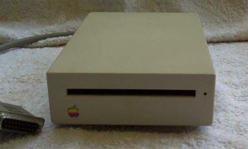

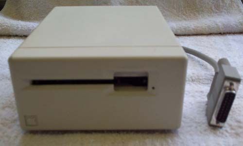

Macintosh 400K (M0130)
The M0130 was designed for use with the original Mac 128K and 512K. It will also work with the Mac Plus and early Mac SE (non FDHD). Apple advise against using the drive with Macs which use an FDHD controller although one person has reported using it with a Mac SE/30.
The M0130 will not work with any Apple II unless a third party disk controller is used. A third party controller was also built to use the M0130 with a PC.
It is one of two Apple 3.5" drives in a beige case.

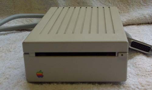

Apple 3.5" External (A9M0106)
The Apple 3.5" External was designed for use with Macintoshes and Apple IIs with a suitable 800K disk controller (eg the Apple IIgs built-in controller or the "SuperDrive controller" in a IIe). Note the eject button and the daisy chain connector (not shown) at the rear. The daisy chain connector should only be used when the drive is used with an Apple II.
The drive can be used on any Mac with an external 19 pin floppy connector. The Mac 512K should use this as a second disk with the HD20 INIT installed on the internal 400K boot floppy. The HD20 INIT provides HFS support for the original Mac ROMs; it is not needed for later Macs.

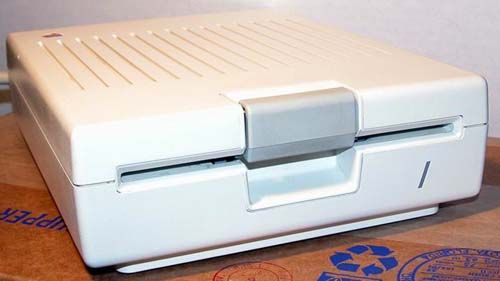

Unidisk 3.5" Drive (A2M2053)
The Unidisk 3.5" has a white case and is designed only for use with Apple IIs. The IIe and earlier require the "Liron" controller card and a ROM upgrade is needed for the early IIc. The drive has a pass through connector.
The IIgs supports the Unidisk 3.5" but the drive is slower than the Apple 3.5" External which should be used in preference. The drive is white to match the Apple IIc case.
(Photo courtesy of Bryan Villados.)

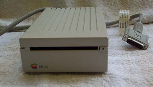

Apple FDHD External (G7287)
The FDHD External uses a similar case to the 3.5" External but the 800K mechanism has been upgraded to a 1.4M mechanism. With appropriate software, it is capable of reading PC format disks in both the Mac and Apple IIgs.
It was designed for use with Macs with an FDHD disk controller (eg SE FDHD, SE/30, IIx, IIci). If used with a Mac that doesn't have an FDHD controller, it will operate as an 800K drive. It should not be used with the Mac 128K or 512K.
The FDHD can also be used with Apple IIs fitted with a "SuperDrive controller" or a suitable third party disk controller. If used with a IIgs that doesn't have a "SuperDrive controller", it will operate as an 800K drive.

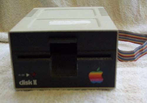

Disk II
The Disk II was Apple's first drive for use with the Apple II. It is attached to the disk controller by a ribbon cable; this can be changed for a 19 pin D connector so that the drive can be used with later Apple II models or the 5.25" drive controller card.
The Apple III and III+ can use a Disk II with a modified analog card; I have not found details of these modifications on the web.

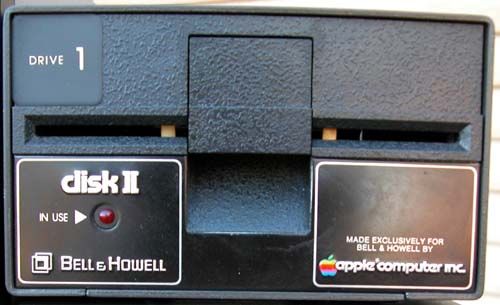

Bell and Howell Disk II
The Bell and Howell drive was manufactured by Apple. It is identical to the Disk II apart from the case colour and labels.
(Photo and information courtesy of Brian Villados.)
