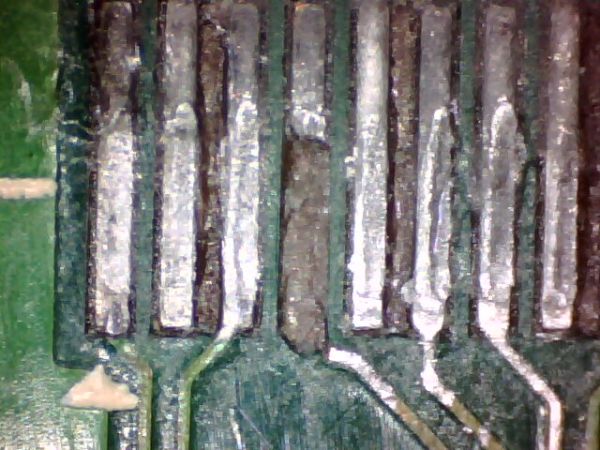

I have 800se without hdmi output. I open and messured resistors as in attached file. All 1.4-1.5 MOm arround "V05" gived me 0.7-0.8 Mom. On fuze 6.4v, not 5v. Possible solutions? Thanks!

You have forgotten to say which ESD protection (D600-D601-D603 diodes) ic has the low measurements.
And which type motherboard you have.
In any case, It could be a defective ESD protection ic, bad print track to/from the cpu, or some damage to the cpu pins, or bad cpu solder ball.
The only way to measure it is to remove the ic with the wrong measurements, and measure it without.
Most of the connections are going to the cpu and the ESD protection diodes.
6.4v question, could be due another type motherboard with newer, different dc to dc (8 pins) ic's.
These measurements are made from a older type motherboard with 16 pins (3850/N5212) dc to dc ic's.
Or, your multimeter is not accurate, or your Dc to Dc 5v ic has some issues.
Nevertheless normally it should be 5vdc.

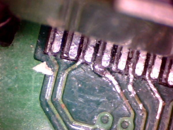

Looks like 4pin contact to print line broken...

To me it seems like the entire connector is not soldered correctly.
It appears to have been placed nearly next to the pins.
Is of course to be measured, the connector solder pins should give the same Ohm value as on the D600-D601-D603 diode pins.
And mostly is the measuring red pen (probe) to thick for this job,
I have added a thin needle to it.

So, under 4 pin out break print line.

Yeah not so fine, but can be fixed with a wire.
1. Lift the pin 4 up
2. Isolate it with (kapton) tape under it from the rest and add a wire to it.
3. Add the wire on the print side to 4 D600
