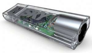

Bus 003 Device 006: ID 07ca:a867 AVerMedia Technologies, Inc. AVerTV DVB-T (A867).

For DM800HD Japhar, install the 2 ipk below, perfectly working, see screenshot attached from my DM800HD with A867 installed and configured.
